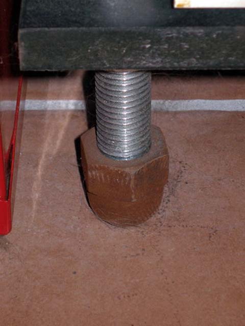

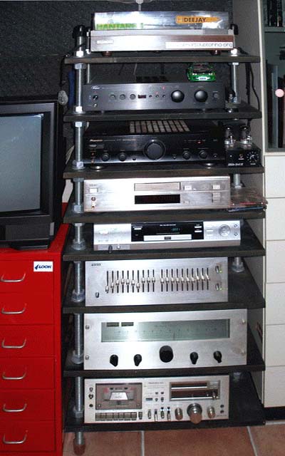

Once the shelves have dried, we move on to the longest and most tedious part: assembling the threaded rods, which must be done in the order shown in Fig. 2. Start at the bottom by screwing the first nut onto each rod at a height of about 10 cm, then attach the blind nuts at the base, which will serve as "feet." Slide the shelf onto the rods from above and add the locknut (this is the tedious part, as the nuts have to be screwed along the entire length of the rod). Wait before tightening everything, then move on to the second set of nuts and the second shelf, and so on until all the pieces are assembled. At this point, refer to the photos I’ve included—they are more explanatory than my words.

Once the shelves are in place, we proceed to levelling them. Some may have wondered why I opted for just three legs. Well, the reason is quite simple. Aside from the aesthetic aspect, having three points of contact ensures the structure is always level. There’s never the classic “fourth leg” problem where, if the floor is slightly uneven, it doesn’t touch and requires a wad of cash (figuratively or literally) to level it.
Levelling is simplified by the fact that we can adjust the height of the shelves using the nuts. With a spirit level placed on the shelf, simply tighten or loosen the nuts beneath the shelf until the desired levelling is achieved. Once satisfied, tighten the nuts above the shelf and move to the next one. This process may sound harder to explain than to actually do.
When finished with the last shelf, I added three blind nuts at the top to give it a neat finish. Potential customizations: for those who don’t particularly like this somewhat techy look, PVC electrician’s pipes can be inserted between shelves, painted black to hide the threaded rods, and the nuts can also be painted. This structure is so modular that you can tailor it to your liking—its only limit is your imagination.
As I mentioned earlier, this design was created to suit my needs, which required a very stable cabinet. And when I say stable, I mean really stable—the entire assembly weighs nearly 55 kg when empty! If your needs are less demanding, you could opt for thinner MDF, smaller threaded rods, etc.
