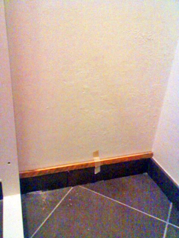

Moving the Switch
The first thing I did was to move the switch to the other side of the door, which allowed me to use a depth of about 60 cm for the storage space instead of 45 cm. Additionally, by doing so, I was able to prevent the frame from covering the heating manifold box, which is visible in the lower right part of the previous photo.
Moving the switch

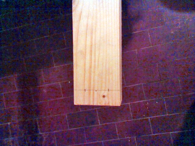

I then marked on the 269.5 cm long side slats the points where to drill holes for the dowels and screws.
Material used for the construction of a built-in wardrobe

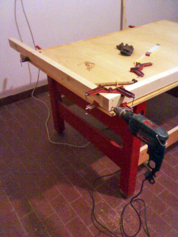

Frame Construction

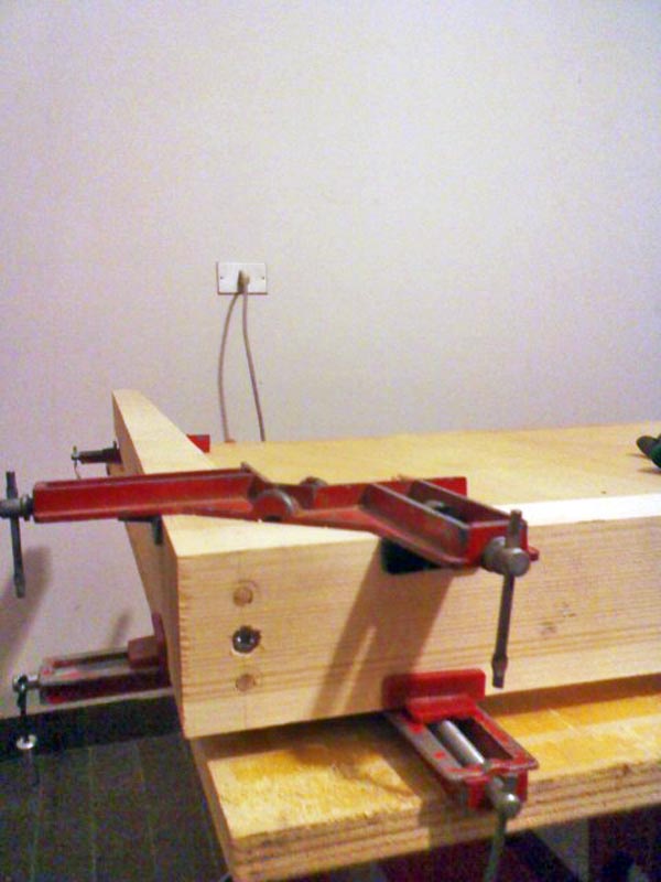

I proceed, with the help of two square clamps, to drill the holes using a 6mm wood drill bit for the dowels and a 4mm drill bit for the screws.
Construction stages of a built-in wardrobe frame

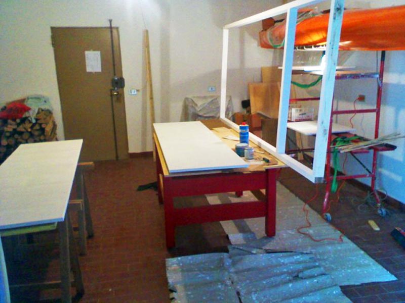

After the glue dried, I cut out the doors and placed them on the frame to verify that the measurements matched what was calculated. Again, I had no problems.
Testing the doors on the frame
I rounded the outer edges of the four doors, as ordered by the lady-master-wife. ;-)
Then I moved on to the painting phase, which I must admit I don't enjoy very much.
I filled all the sides of the doors with putty and sanded both the frame and the doors with fine-grit sandpaper for wood, then applied the first coat of primer.
Once the first coat had dried well, I sanded again and applied the second coat of primer, another sanding, and finally the white enamel.

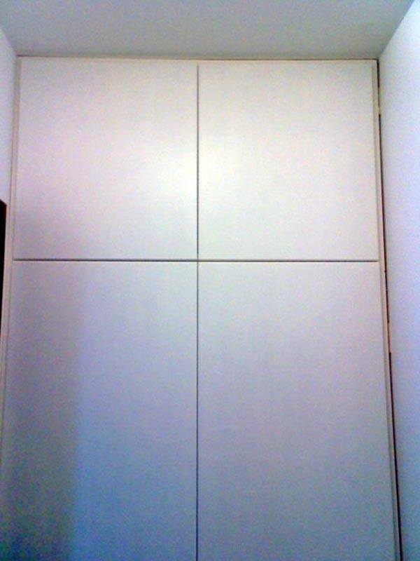

Fitting the doors of a built-in wardrobe
After attaching the doors, the built-in wardrobe is starting to take shape.
Assembling the doors of a built-in wardrobe

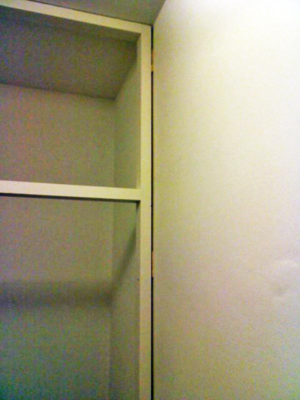

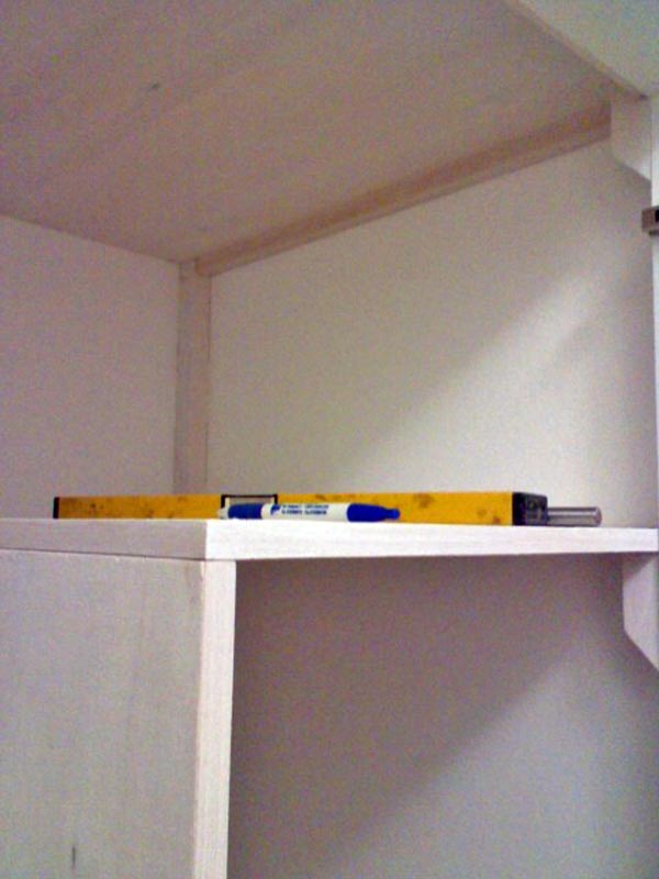

Now let's move on to the interior, nothing exceptional...
I didn't make any more holes in the wall after accidentally hitting the gas pipe; I preferred not to take any more risks, at least in that corner of the house.
The slats I placed in the internal corners were fixed with a bit of silicone.
Assembling the internal shelves of a built-in wardrobe
I must mention that the hooks are temporary; to hang the ironing board, I will install a rail (the ones used for sliding tabletops) which I currently couldn't find either at the DIY store or the hardware shop.
Interior of a built-in wardrobe

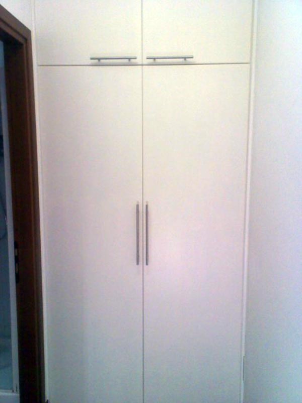

Finally, I installed trims to cover the framework and the empty spaces between it and the wall. This is the final effect of the built-in wardrobe with the doors and handles installed.
Built-in wardrobe assembled and finished
