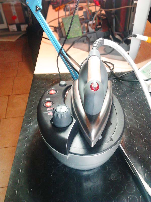

Appliance:
Polti Vaporella Easy Professional Iron
Issue:
Instead of steam, the iron releases water, and the soleplate barely heats up or doesn't heat at all.
Repair:
The soleplate wasn't heating at all; the slight warmth felt on the plate came from the boiling water being sent from the boiler to the soleplate.
The first thing to check was the red light on the button—it was off. The reason was that no voltage was reaching the thermostat because the thermal fuse on the thermostat had blown. (This issue is very common with many steam irons.)
