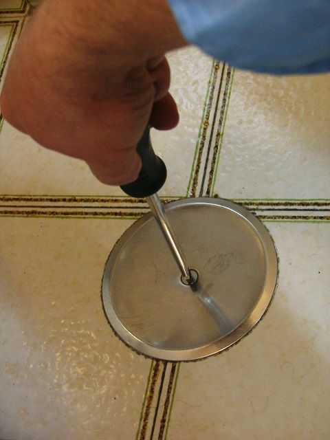

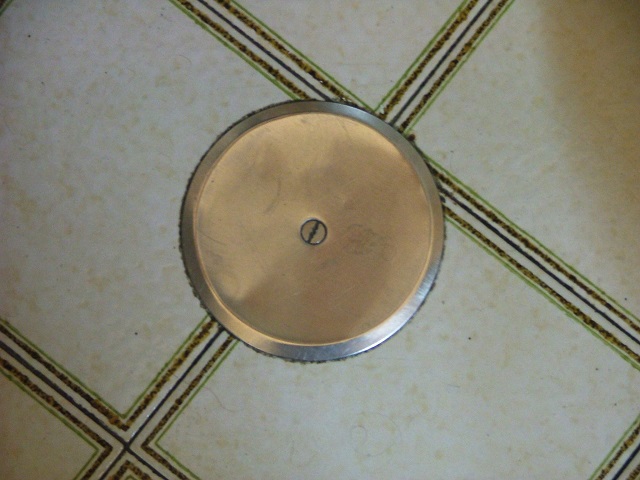

If water is seeping from the siphon box, the most likely culprit is a loose cap. Simply tightening the screw should compress the rubber gasket at the centre of the cap, allowing it to expand and properly seal the drain.
If this doesn’t fix the issue—and especially if the cap still wobbles even after tightening the screw—don’t worry. Some siphon box models have an internal locking mechanism, and the visible screw is only there to secure the metal plate. In this case, unscrew it, remove the plate, and try turning the hidden “knob” inside.
unscrew the screw and remove the metal plate

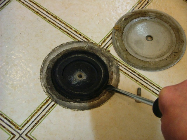

If the previous steps don’t solve the issue, you’ll need to remove the cap and replace it with a new one.
In theory, if the cap is designed as shown in the diagram, loosening the screw slightly should release the pressure seal, allowing you to slide the cap out. However, experience has shown that the gasket often gets stuck, so the best approach is to fully unscrew the bolt and gently pry the cap loose with a screwdriver.
Remove the cap from the siphon box

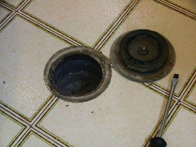

During the removal process, the lower part of the cap might detach and fall to the bottom of the drain. If this happens, don’t worry—it can be easily retrieved using a screwdriver or a pair of pliers.
If you need to replace the expandable cap of the siphon box, make sure to purchase one with the same diameter. Before heading to buy a new piece, take the necessary measurements of the old one to ensure a proper fit.
Siphon box with dismantled expansion cap
