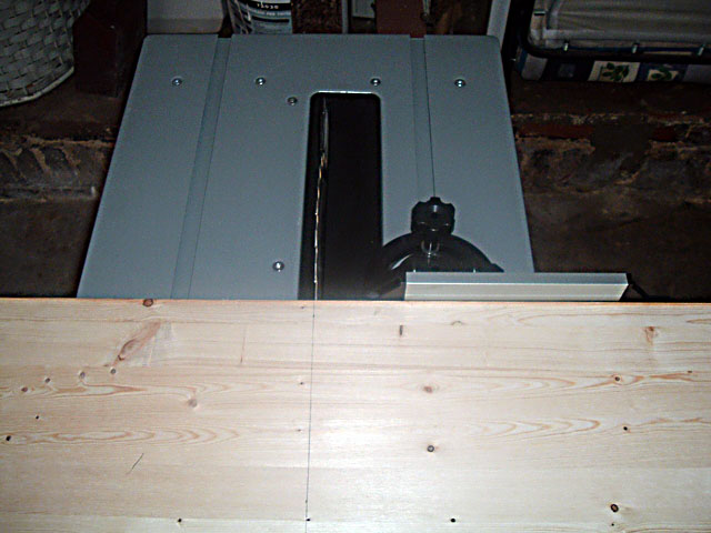

But I didn’t lose heart and decided to treat myself to a gift: a small circular saw with a table. It’s nothing fancy, but it will definitely make the next cuts much better.

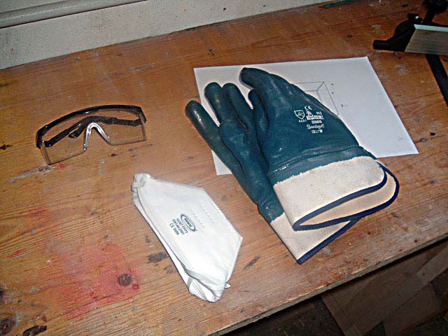

Let’s move on with a small recommendation: when using tools such as a circular saw, an electric planer, or a sander, make sure to equip yourself with gloves, a mask, and protective goggles. The ones you see in the photo were provided by my workplace, but they are easily available on the market.

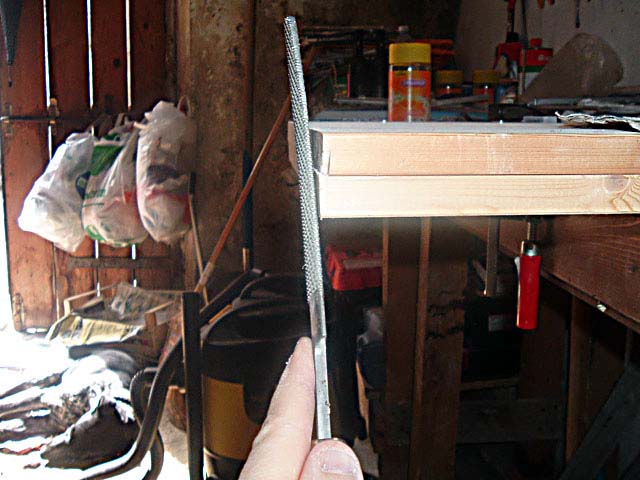

The workbench is, understandably, narrow, while the board is huge, which means I had to cut freehand, without using guides. This is exactly why I recommended earlier to choose boards with dimensions as close as possible to the ones you need.
As expected, the cut isn’t perfect, but it’s not too bad either… and everything can be fixed. Even though the cut didn’t come out perfectly, it’s not a serious problem—a quick file, and you’re good to go!

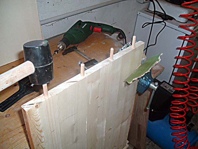

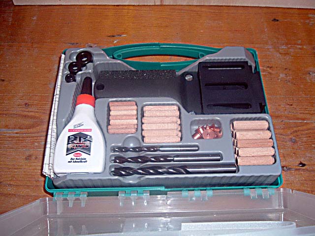

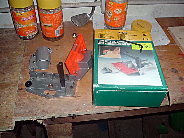

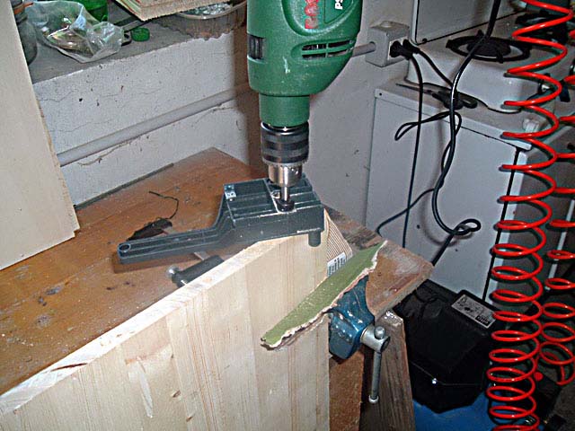

For the assembly, I used round beech dowels—I recommend purchasing a complete kit like this one. For this type of joint, it's essential to drill holes to the correct depth: since the dowels are 4 cm long, the wood is 1.8 cm thick, and the joint is L-shaped, the dowel needs to be inserted about 28 mm into the vertical piece and 12 mm into the horizontal one. The tool shown in the photo is a dowelling jig, which allows you to drill perpendicular and centred holes in the wood. At the top of the drill bit, there’s a depth stop that needs to be properly adjusted.
We drill and insert the dowels, using a rubber mallet to assist.
We secure the two pieces to the workbench in perfect alignment—the one with the dowels already in place and the one it will be attached to. Using the guide, we drill the corresponding holes. It’s always a good idea to mark the pieces and the joint points (using pencil marks so they can be easily erased).

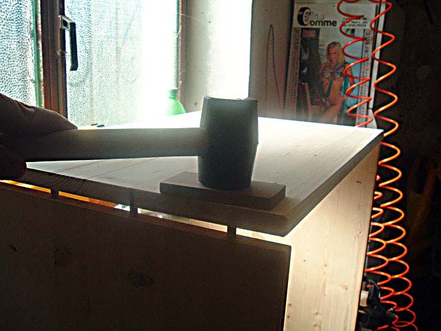

Let’s use the usual rubber mallet, placing a piece of plywood in between to protect the wood. It’s advisable to add a drop of PVA glue to secure the dowel joint, but only once the work is finished, as the cabinet will still need to be taken apart several times.

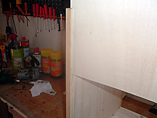

Let me explain how I tackled the back panel of the cabinet. Simply nailing the plywood panel felt too basic—not to mention the risk of doing a poor job due to crooked nails. So, what did I do instead? Here’s the idea.

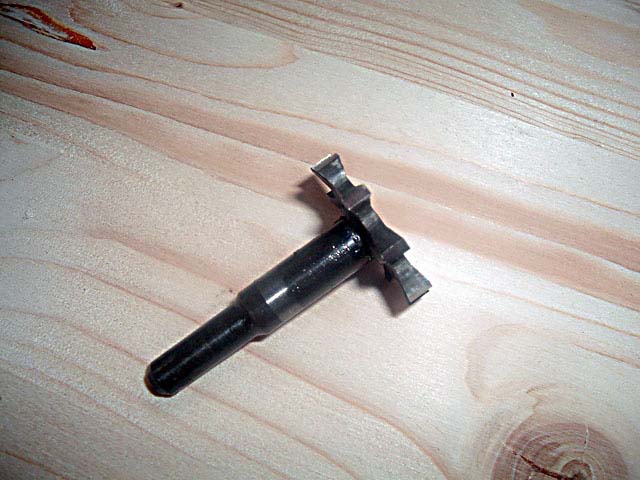

When purchasing router bits, it's important to pay attention—not just to the quality, which depends on how much you’re willing to spend—but also to their intended use. There are primarily two types of router bits: low-speed bits, which operate at around 3,000 RPM and can be used with a standard drill (like the one I’ll be using), and high-speed bits, which are designed exclusively for routers that can reach up to 20,000 RPM. It’s crucial to ensure the bit you buy is suitable for the tool you have. This is a simple 5 mm groove bit.

Once the adjustment is satisfactory, we proceed to rout the cabinet pieces. Even if the routing isn’t perfectly straight, it can still work just fine. We create a groove on the three pieces that make up the base and the cabinet walls along the rear side. Then, we prepare a 4 mm thick plywood sheet of the correct dimensions and slot it into the guide.
Next, simply secure the top piece, and the cabinet body is complete.

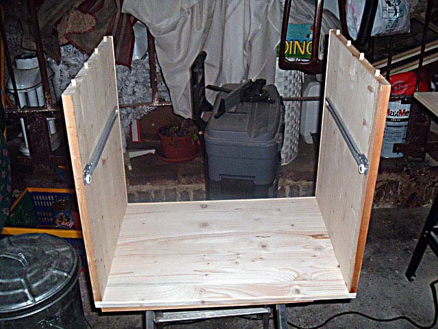

Now it's time to talk about the drawer. Essentially, I built it in the same way as the cabinet body: the four sides are joined using dowels, and the bottom is secured via a groove—made slightly deeper to provide extra rigidity.
These are the full-extension under-drawer slides, which are commonly available at hardware stores.
The only challenge is figuring out exactly how much space they will occupy, especially since they are slightly different from each other. Only one of them can be assembled without having the two parts mounted on their respective wooden supports. In the end, my drawer turned out to be a few millimetres too wide, and I resolved the issue by removing a thin layer of wood where the slide is fixed. To do this, I used a high-speed rotary tool and a coarse-grit sandpaper brush.

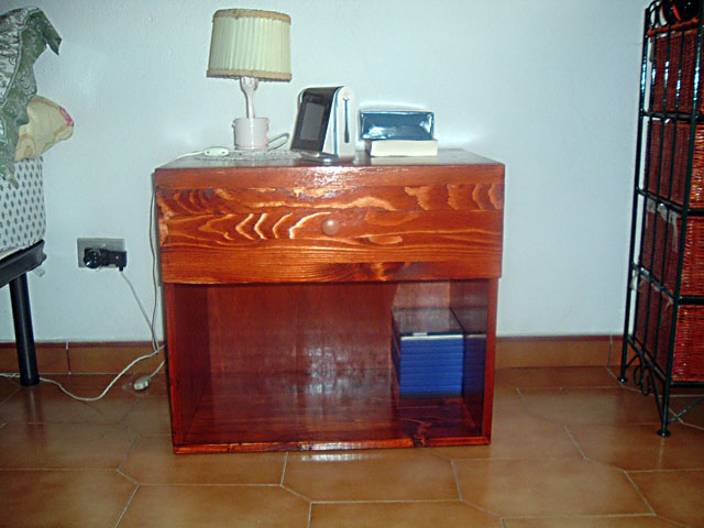

The painting process involved applying two coats of cherry-coloured wood stain, followed by two coats of clear wax-effect varnish. In the photos, it appears much shinier than it actually is. The only downside was that I purchased solvent-based products, suitable for outdoor use, instead of water-based ones, which I initially didn’t spot. As a result, there was an unpleasant odour after painting, but it has now completely disappeared.
