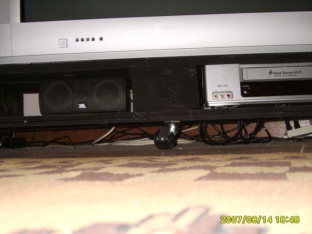

The wheels used are "free-swivelling," meaning they can rotate to allow movement in any direction. This type of wheel (visible in the photo of themago's project) can be easily purchased from well-stocked hardware stores and is available in various sizes.
To attach the wheels to the pallet, four wood screws for each wheel will suffice.
The only precaution to take when selecting the wheels is their load capacity. In this case, as the setup includes a 32" TV, a VCR, and other items, the estimated weight was calculated with a safety margin at around 100 kg. Divided across six wheels, this means each wheel should support approximately 16–17 kg.
When purchasing the wheels, ensure that the maximum load capacity specified is not less than this calculated weight.
