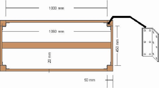

The Project Design
First and foremost, let’s start with the design for sizing the table:
DIY Kitchen Table Project Drawing

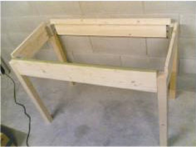

I made the legs as follows: I went to a BRICO centre and bought a 5 cm x 5 cm wooden post, 3 metres tall. At these centres, they offer free wood-cutting services. I originally wanted the legs cut to 80 cm each, but since 80 x 4 = 320 cm, I had them cut to 74 cm each instead. That’s all there is to it.
Detail of the table legs

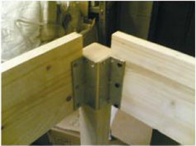

Attaching the Table Legs
To attach the legs to the rest of the structure, I used aluminium brackets (also purchased from the BRICO store) with a thickness of 2 mm. I cut them to approximately 11 cm each, and the holes you see are used to secure the legs to the boards.
Fixing the legs to the table

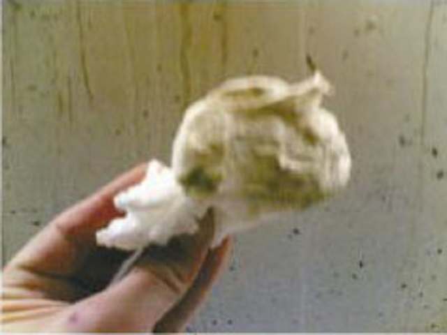

The wad in my hand is simply some toilet paper soaked in water and ammonia. This is rubbed on the wood before painting to ensure the wood’s pores open properly.
Cleaning wood before painting

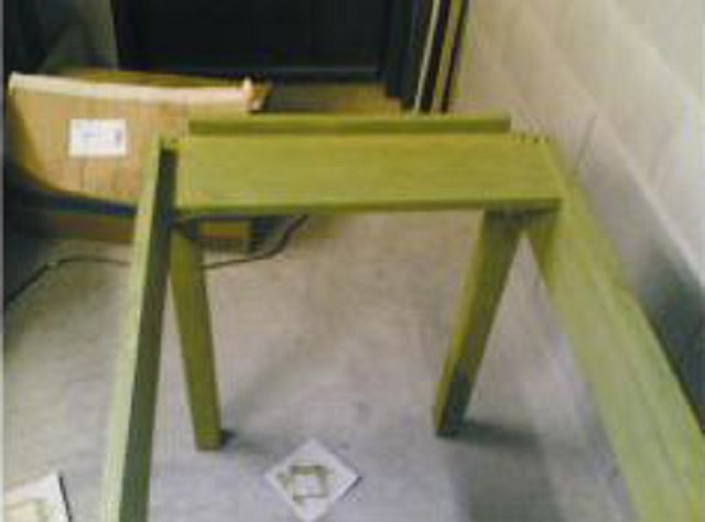

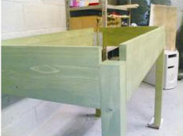

Installing the Reinforcements
In the end, instead of using a single board as reinforcement running the full length of the table (as shown in the initial design), I found it more stable to place two reinforcement boards along the narrow sides of the table, as shown in the photo.
DIY Table Reinforcement Assembly
