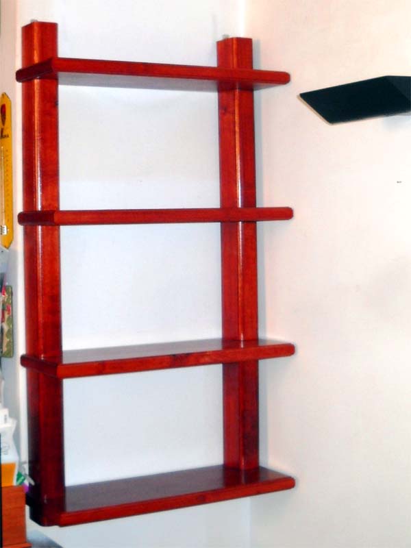

The bookshelf will be made in two sections: a smaller one with 4 shelves, standing 84cm tall and 45cm wide, and another with 2 shelves, 45cm tall and 260cm long. Both sections will be wall-mounted. To prevent the longer shelves from warping or cracking over time, they will be made using hollow-core construction.

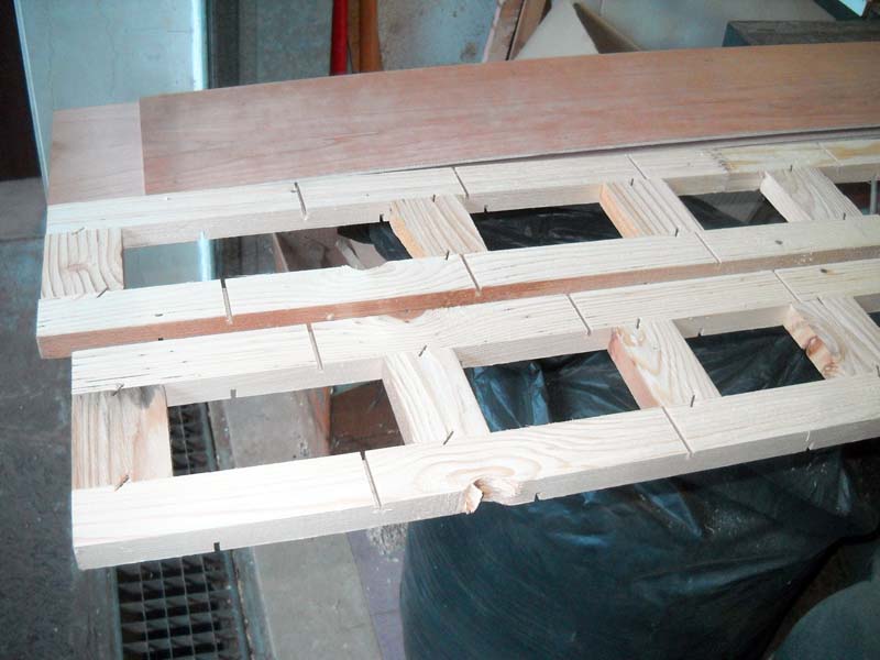

How to Prepare Hollow-Core Construction

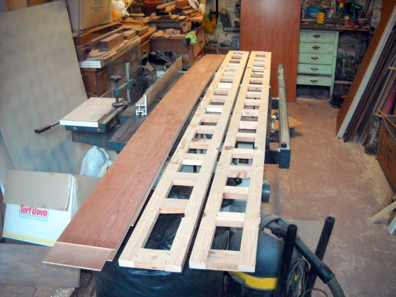

Hollow-core construction consists of an internal wooden framework (usually made of fir) that is then covered with "veneered" plywood or other materials. Once the wooden strips have been "stress-relieved," they are joined together with metal staples to form the internal framework. By "stress-relieving," we mean transverse cuts made alternately on both sides of the wooden strips to prevent the wood from bending over time.
Preparing the honeycomb structure with wooden strips
The framework is then covered using plywood. In this case, six pieces of "veneered" plywood with cherry wood were cut to size.
Not having a workbench long enough to glue the plywood, I had to turn to a carpenter who placed them under a press.
The structure is completed by gluing pieces of plywood ennobled with cherry wood

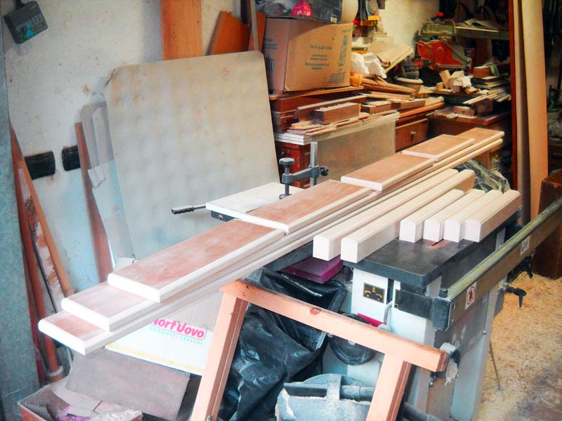

Creating the Uprights

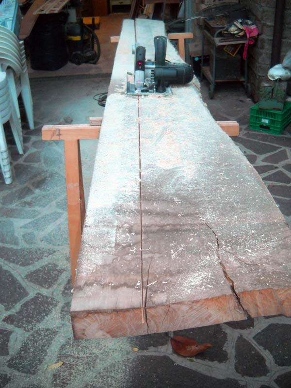

Since cherry wood planks weren’t available, the uprights were made from a maple plank, which closely resembles cherry. Once stained (as tested before), the difference will hardly be noticeable.
The plank was cut using a handheld circular saw. Since the saw didn’t have sufficient cutting depth to slice through the plank in a single pass, the cut was made in two steps, after marking the line to follow.
The uprights were made from a maple wood board

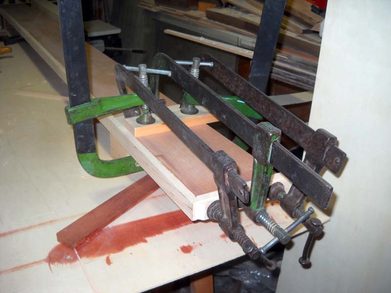

The Edging Strips

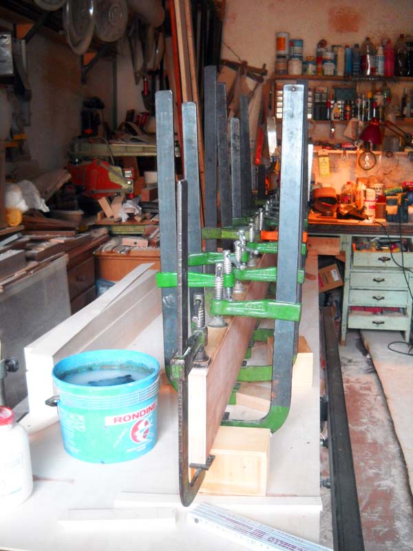

The edging strips were also made from the maple plank. Once cut to size, they were glued to the edges of the hollow-core panels to cover the fir framework and the plywood edges.
Gluing the cover strips

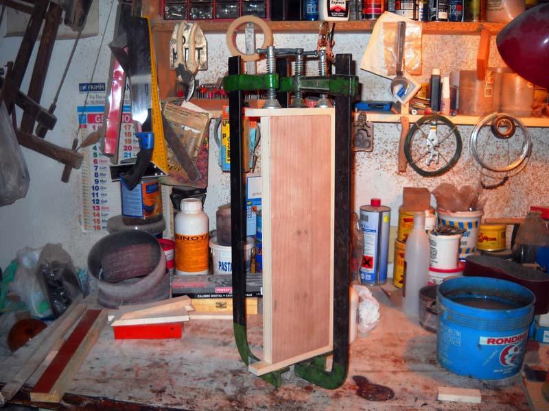

Everything then needs to be clamped until the glue has completely dried.
The cover strips are glued and held under pressure with clamps
Given the difficulty of having clamps longer than 260 cm, and to avoid using nails whenever possible, a small wooden board was placed across the surface and secured in position. Clamps were then attached to this board to apply pressure to the side edgings.
A board stuck crosswise was used to pull the clamps

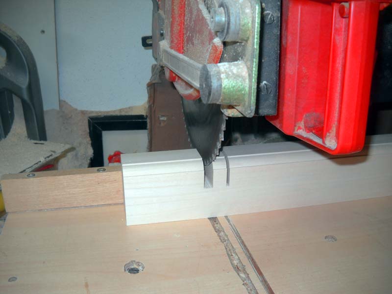

Next Steps: Preparing the Notches
Once the points for the joints with the shelves have been marked, the notches are made using a radial mitre saw. This is done with successive passes, moving the piece incrementally each time.
Preparing the cut-outs on the uprights

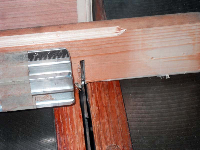

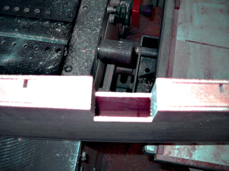

Using a Sacrificial Piece of Wood

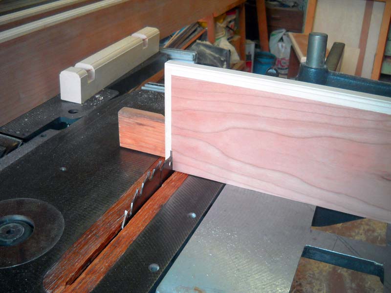

The same approach is used to create the notches on the shelves, but this time with the table circular saw. It’s important to place a board, known as a "sacrificial piece," between the shelf and the stop on the saw carriage to prevent the outgoing blade from splintering the wood.
Making the recesses on the shelves
In this photo, you can see how the outgoing blade splinters the sacrificial piece rather than the wood of the shelf.
Using the martyr piece of wood to prevent wood chipping

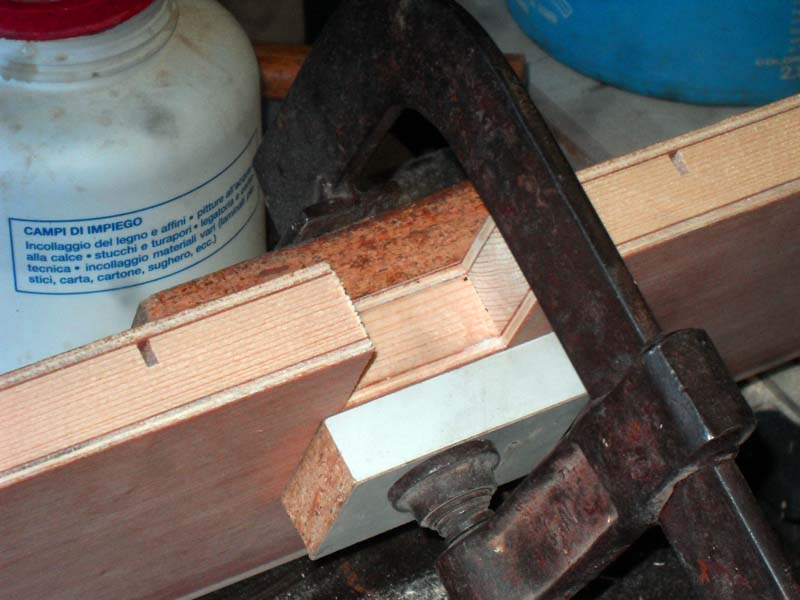

If the Notch Meets an Empty Space in the Hollow-Core Panel
Since we're dealing with hollow-core panels and not solid wood, creating a notch on the shelf carries the risk of not hitting the internal crossbeam where the fixing screw can hold. Instead, as in this case, you might encounter an empty space.
Notch on the Shelf with an Empty Space
Nothing to worry about, of course. Simply cut a wooden plug to the right size and glue it inside the hollow space. Clamp it securely until the glue is completely dry, and everything will be perfectly fine.

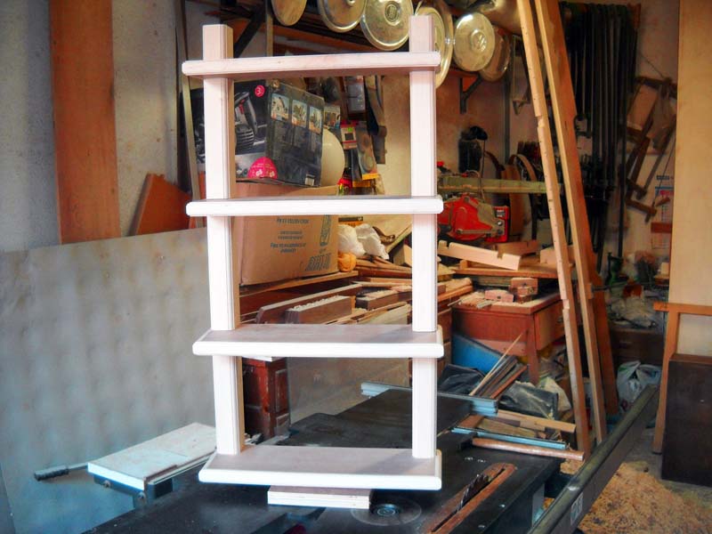

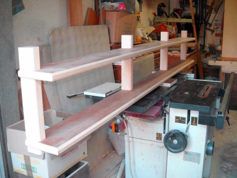

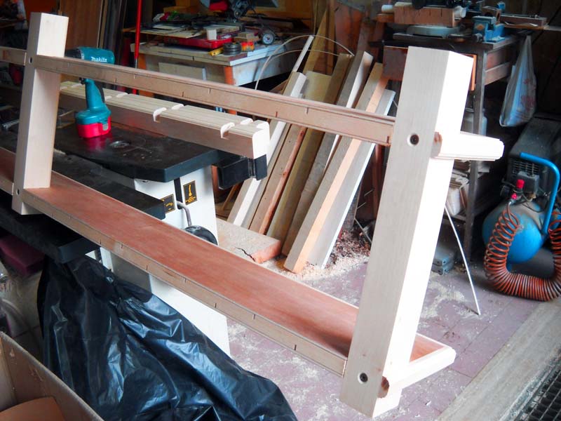

Final Assembly
At this stage, the pieces can be assembled, ensuring that the notches fit together correctly. Pre-drill the holes for the wood screws to prevent the wood from splitting, and countersink for the screw’s conical head to ensure it doesn’t protrude.
Assembling the pieces of the open bookcase
And this is how the bookshelves look once correctly assembled.
Large assembled bookcase
Small assembled bookcase

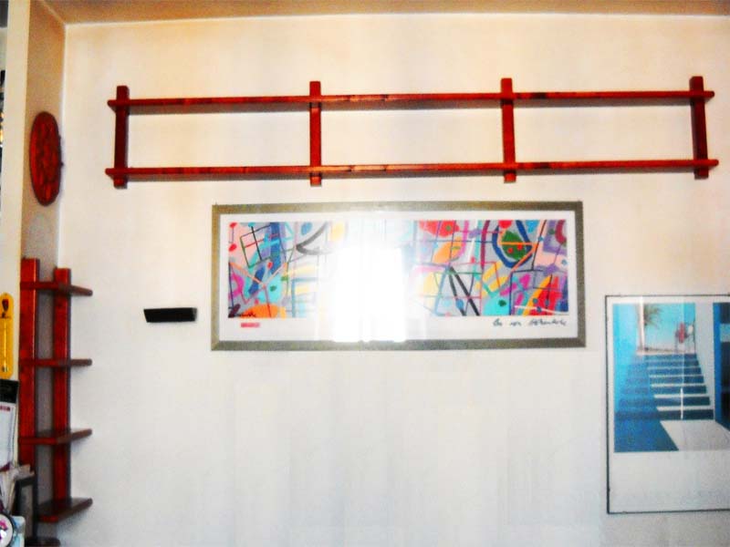

Final Effect
And here is the final look of the bookshelves, properly painted and mounted on the wall.
As you can see, once everything is painted, the colour difference between the cherry wood shelves and the maple wood edging is barely noticeable.
Large bookcase finished
Small bookcase finished
