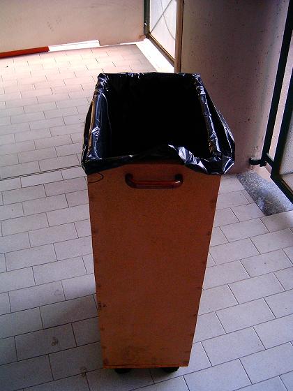

Assembly of the Recycling Bins
At this stage, the bins should be assembled by attaching the parts marked as "A," "B," and "C" in the diagram. To secure them, it’s best to use glue and screws suitable for the material you're working with—there are specific types for wood, chipboard, or MDF. It's essential to drill a pilot hole with a bit smaller than the screw’s diameter to prevent the wood from splitting, as screws are conical in shape.
If you’re using screws with a countersunk head, it’s advisable to countersink the hole first with a 10 or 12 mm bit for metal before inserting the screw.
Mounting the Wheels
Once this is done, swivel wheels and handles will be attached, allowing the bins to be easily pulled out from their housing for emptying or moved wherever needed. To complete the project, the base should be properly prepared and given a couple of coats of paint. Naturally, even though the project includes only two bins, there's nothing stopping you from adding a third one if you have enough space.
