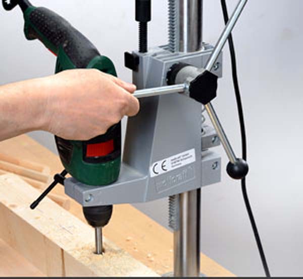

To create the disc without a hole, a drill press or, as in my case, a drill stand is required. Simply retract the hole saw's central bit so it doesn't penetrate the wood, and secure the wooden board in the stand's vice.
Additionally, it's advisable to place another piece of wood beneath the one being cut. This prevents the pressure from the cutting tool from pushing the piece downward.
Pillar drill stand
