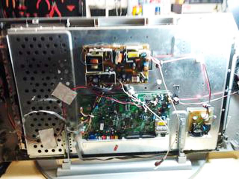

The TV turned off with a bang and smoke coming from behind the panel.

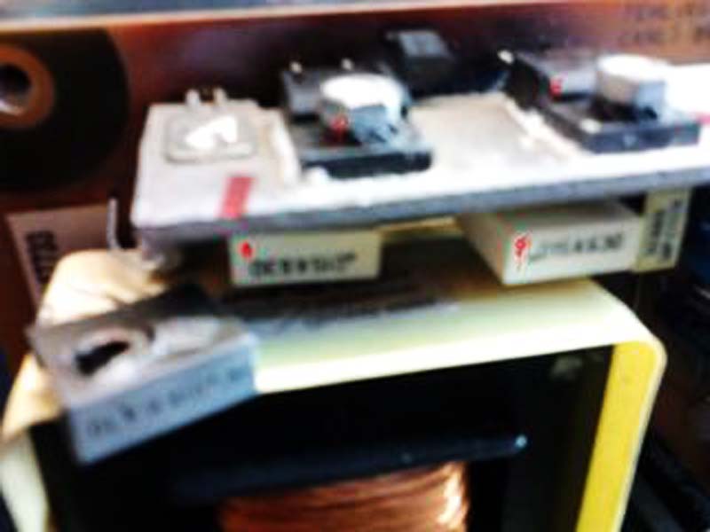

Repair: Upon opening the TV, I immediately noticed a charred area with two completely blown 12nF 400V capacitors. I replaced them with 12nF 630V capacitors and, for safety, also replaced the two SND13N50F transistors. The TV started working again.
This type of fault is very common in this model, although I still haven't figured out why that part of the TV gets so hot.
