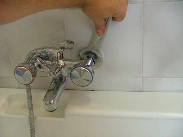

After shutting off the main water supply, open the taps of the faucet you’re replacing to release any remaining water under pressure. Then, using the appropriately sized wrench (a 30mm in my case), unscrew the two nuts securing the faucet to the pipes coming out of the wall.

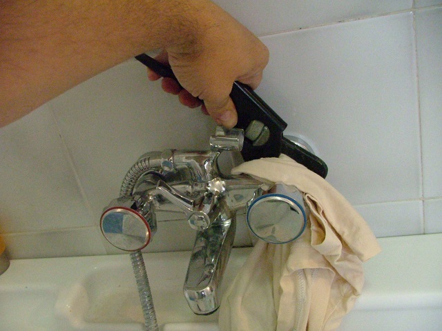

If you don’t have the right-sized wrench, you can use an adjustable pipe wrench. To prevent damage to the chrome finish, place a cloth between the wrench and the nuts. Start by loosening both nuts, then unscrew them alternately—about one full turn to a turn and a half each time.

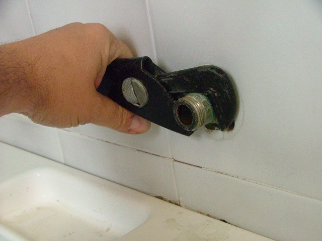

After removing the faucet unit, sliding off the chrome rings will reveal threaded pipe connectors screwed into the wall pipe. These fittings have an offset axis where the faucet attaches, compared to the section screwed into the wall, resembling a sort of crank. These connectors are called "eccentric fittings."
They are used because it would be difficult for a plumber installing pipes in the wall to position them precisely at the right distance for the faucet. Additionally, not all faucets have the same pipe spacing (center distance), so...

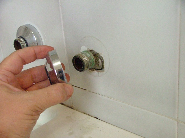

If you’re lucky enough to find a new faucet with the same center distance as the old one (bringing the old faucet as a sample when purchasing the new one is ideal), the installation will be much easier. Otherwise, you’ll need to remove both eccentric fittings and install new ones, properly sealed with Teflon tape or hemp (known as "oakum") and green sealing paste.
Adjusting the New Eccentric Fittings
The eccentric fittings should not be screwed in completely. After about five or six turns, they need to be adjusted to the correct height and spacing to ensure the new faucet can be attached without excessive strain on the nuts.

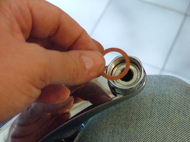

Once the eccentric fittings are properly positioned, insert the supplied gaskets into the nuts of the new faucet—no Teflon tape or hemp is needed for this step.

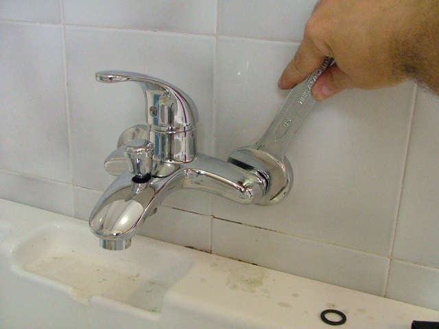

At this point, simply insert the new chrome rings (usually supplied with the new faucet set) and screw on the nuts. As when removing the old ones, tighten them alternately—about one full turn to a turn and a half each time—until they are fully secured, avoiding excessive force.
