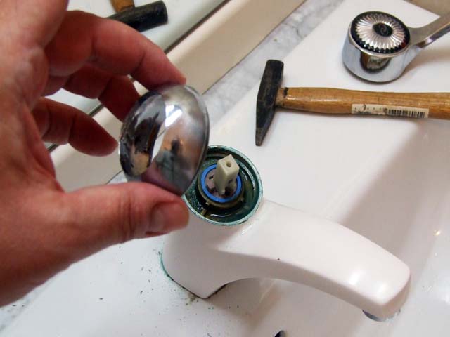

STEP 2 - Removing the Chrome Cover
After removing the lever, you will see a chrome-plated cover with a central hole, through which the square spindle that holds the lever protrudes.
This component, typically made of plastic or metal, must be unscrewed to remove it and access the cartridge.
Sometimes, unscrewing it can be tricky, as dust and limescale deposits from water can accumulate in the threading, making it difficult to loosen.
If the cover does not unscrew easily, try using a descaling and release spray. These sprays are available from hardware stores and DIY shops, and can be conveniently applied using a thin nozzle, even through the top hole.
Even with the use of a release oil, removing the semi-spherical chrome cover can be tricky, mainly because it’s difficult to firmly grip a piece with that shape.
A useful tool for this task is a rubber strap wrench (as shown in the image), typically used for removing car oil filters.
Alternatively, if you have a standard metal band filter wrench, you can increase grip and prevent scratches by placing a rubber strip (such as a piece cut from an old bicycle inner tube) between the metal band and the chrome cover before loosening it.

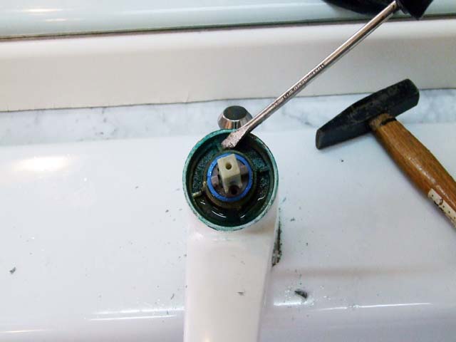

In the tap shown in the picture, this function is performed by a threaded locking ring with four tabs, which are designed to be unscrewed using a special key.
However, since very few DIY enthusiasts will have such a key, an alternative method must be used to loosen the ring. I usually rely on one or two screwdrivers in the following ways:
- Single-screwdriver method: Place a flathead screwdriver against one of the tabs (as shown in the picture). Then, gently tap the handle with a rubber hammer to loosen the ring.
- Dual-screwdriver method: Position two screwdrivers vertically against two opposite tabs, holding their handles with one hand. With the other hand, insert the rubber hammer handle between the screwdriver shafts as low as possible, and use it as a lever to rotate the ring counterclockwise to unscrew it.
The first method is more effective for breaking the seal but should be used with caution, as excessive force could damage the ring. The second method works best when the ring is difficult to loosen but isn’t completely stuck.

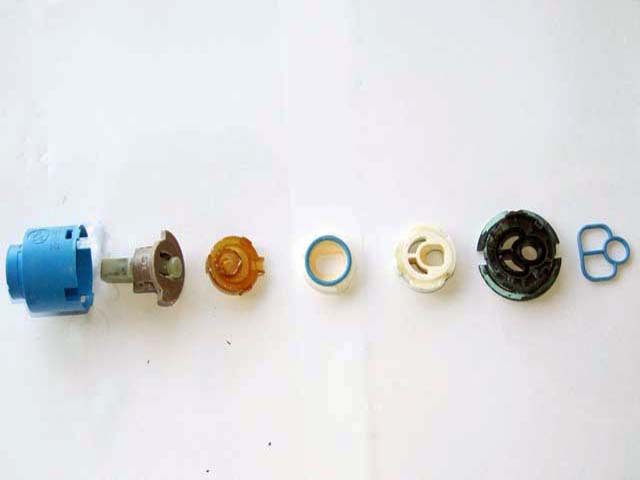

The mixer cartridge should be extracted carefully, as there is a rubber seal underneath that may have partially adhered to the housing.
If this happens, it’s important to detach it gently, as not all manufacturers include a replacement seal with the cartridge. If the seal breaks, it could create a problem during reassembly.
STEP 5 - Replacing and Reinstalling the New Cartridge
The image shows how the cartridge and its seal appear after removal.
Since there is no universal design standard for these cartridges, it’s highly recommended to bring the original part as a sample when searching for a replacement.

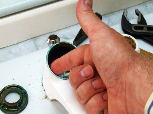

Before reinstalling the new cartridge, it’s good practice to thoroughly clean the inside of the tap, particularly the thread where the locking nut will be screwed on.
Applying a light layer of food-grade petroleum jelly or oil to the thread using a finger will help ensure smooth assembly and prevent future sticking.
