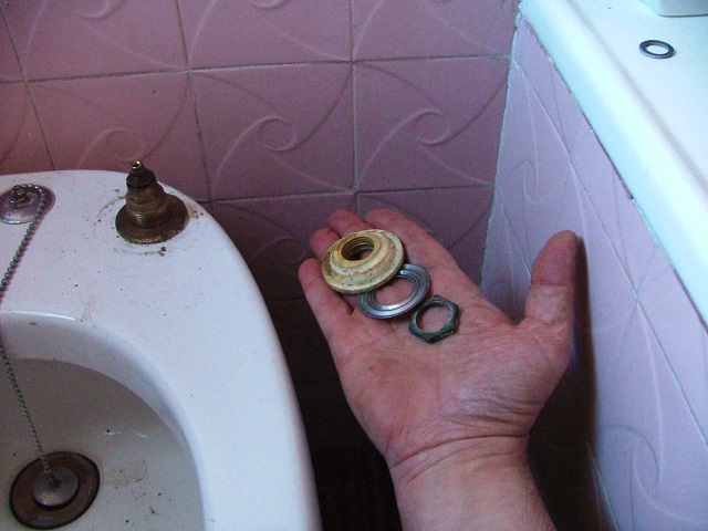

After ensuring that the main water supply is turned off, proceed by unscrewing the water inlet pipe from the faucet. Then, using an appropriate wrench, loosen the nut at the bottom that secures the faucet in place.
Once these steps are completed, you can remove the washer and the lower gasket.
Bidet faucet lower gasket and washer nut

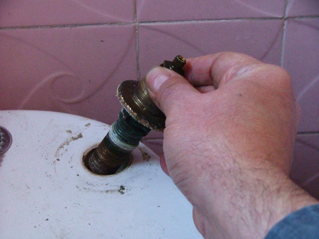

Removing and Cleaning the Faucet
Now, the faucet body can be lifted out of its position, and the area can be cleaned using a cloth and a bit of alcohol. For more stubborn buildup, a utility knife blade can be used to scrape off the residue.
Dismantle the tap from the bidet

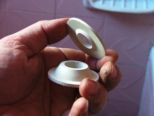

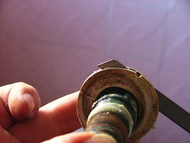

If the upper gasket is glued in place, you can remove it with the help of a utility knife blade. Once removed, carefully clean the seating area to eliminate any remaining residue from the old gasket.
Next, install the new upper gasket (the thinner, flatter one), ensuring that the slightly conical side faces the bidet.
Place the faucet back into position, install the lower gasket (with the conical side facing the bidet hole), add the washer, and tighten the nut. Finally, reconnect the water pipe, and… your faucet will no longer leak!
